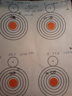

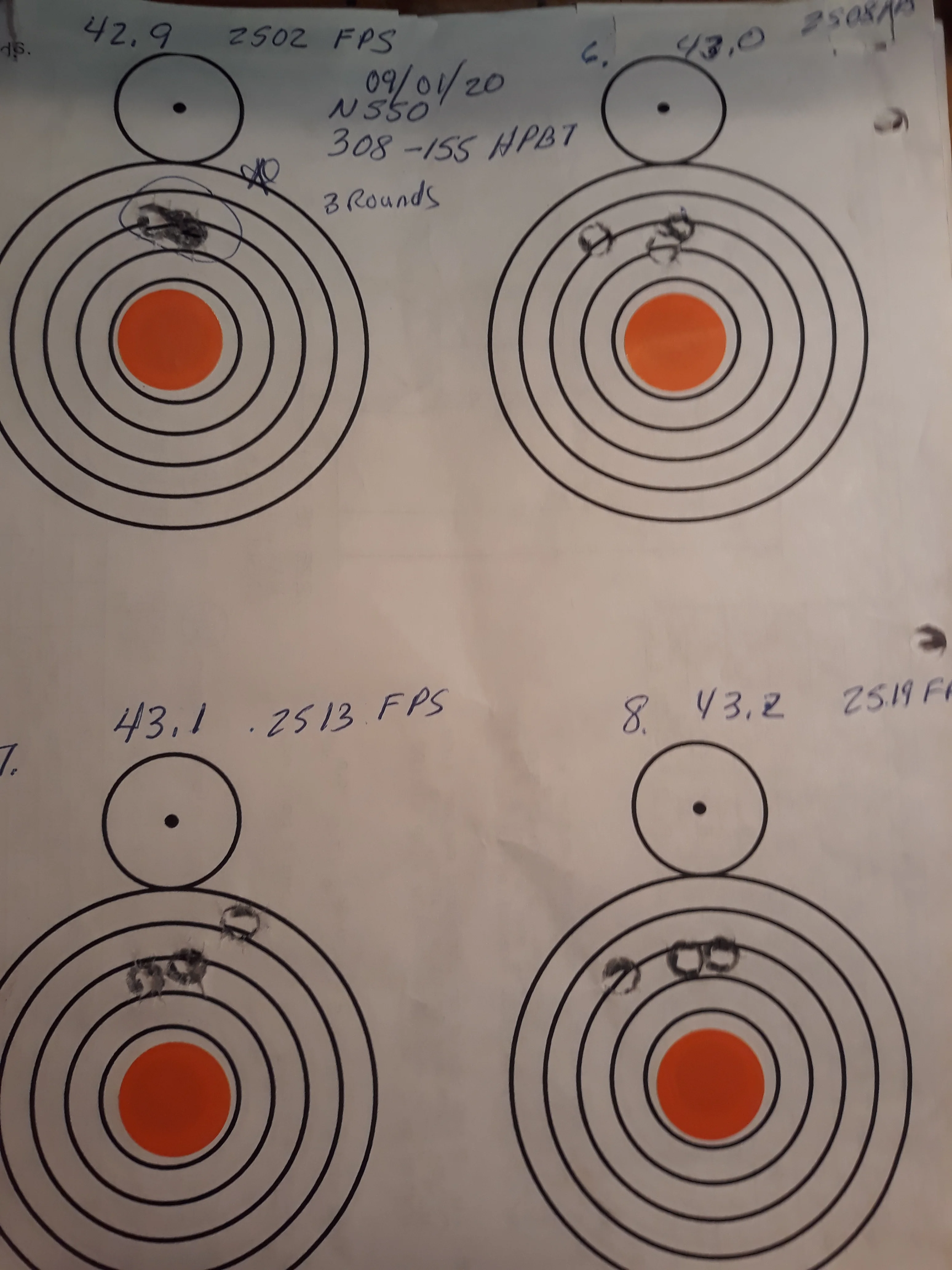

My Reminton slings 155.5 out of a 26 inch tube for under a 1/4 MOA at 100 yards. N550 keeps the numbers at 2500 FPS not that fast but it is what the Remington likes.
    372.9 KB
